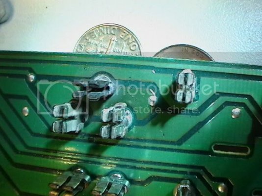

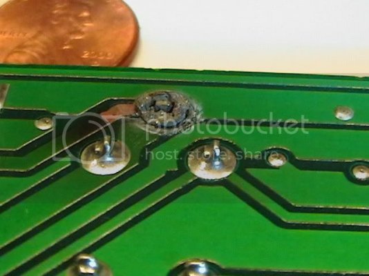

Sorry to bring this up, but it happened again. This time, though I know why it did what it did.
According to this, the early build 2003 Expys had a bad Central Junction Box (the fuse box) design, causing the PCM relay to burn out, among other things.
I took my box apart (before I had found the above link) since the Expy just shut off on me one day while driving, and the buzzing started. Replacing the PCM relay didn't do anything. Had to get it towed to my place.
This is what I found when I opened up the box:
Bottom
Top - the dark, horizontal
Here's a little diagram I made
http://i96.photobucket.com/albums/l183/Jjokin3much/PCMrelay.jpg
It is prong number 5 that is burnt out in the board.
According to the link, I need to order part 3L1Z-14A068-AA (for vehicles before build date 2/3/03). You need part number 3L7Z-14A068-AB for vehicles after 2/3/03.
I'll hopefully be replacing it tomorrow, so hopefully it'll start. *fingers crossed*:D
