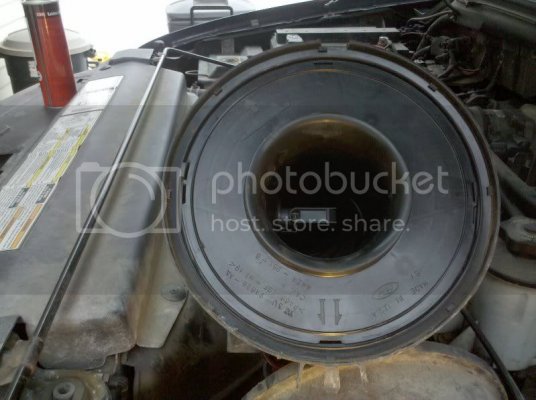

The other thing to check is your MAF.
It's the Mass Air Flow sensor. It's located in the air inlet tube that comes from where your air cleaner/filter is. Just disconnect your air inlet tube ahead of the sensor, and spray some MAF cleaner through the screen at the little elements in the center of the sensor. Let it sit for 5 minutes or so...,give it another shot, let it sit for another 5 minutes, then start your engine. Some people just use electronics cleaner, but I recommend actual MAF cleaner from the auto parts store. You can also take the sensor right out and clean it that way too, but it's easiest to just spray it where it is. You can hold a rag or something behind it. Here's a pic of what you are looking for. Mine looks a little different on my engine, but it's pretty much the same idea.

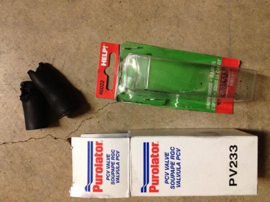

Just wanted to say thanks for posting this. I did some searching around and got lucky to have come across this thread. I was having these same issues during the cold months over the last year. Over the last week (as temps dropped into the 40's here in South, TX) the idle quality deteriorated to the point that I was unwilling to drive my 2000 Expy. First thing I did was look for vacuum leaks. I found a few. The worst was at the elbow connected to the pcv valve. It had completely caved in on itself and actually had a tear at the bend. I went to Oriely's and purchased the el below for 8 bucks and a new pcv valve for 3 bucks. I also changed out the hose connected at the upper rear port off the throttle body housing as it was severly corroded. I also cleaned the maf just to be on the safe side. Took it for a drive and it drove great and most importantly idles great. Here are some pics of the el I purchased. Thanks again.
