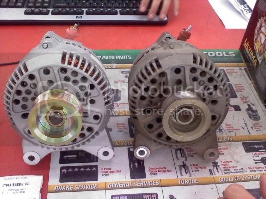

new vs old

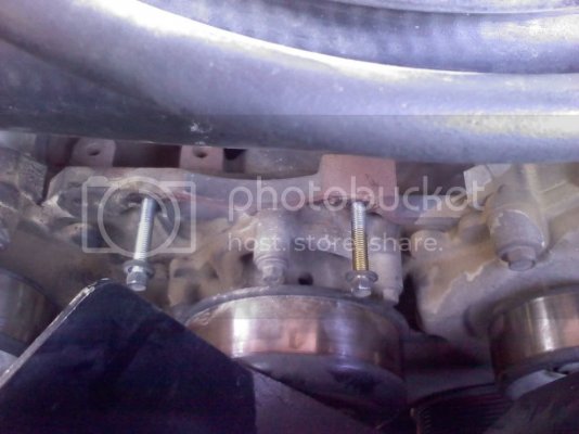

the two bottom bolts.

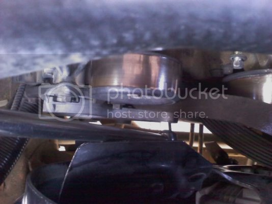

how i barely got it on. (thats what she said.) but when i was trying to get it out it went all the way in. (again, thats what she said.)
you can see. no room to move when taking it off. thats why i good pair of pliers and squeezing it off will work better then trying to muscle it off.

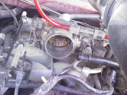

tb with intake moved out of the way.
