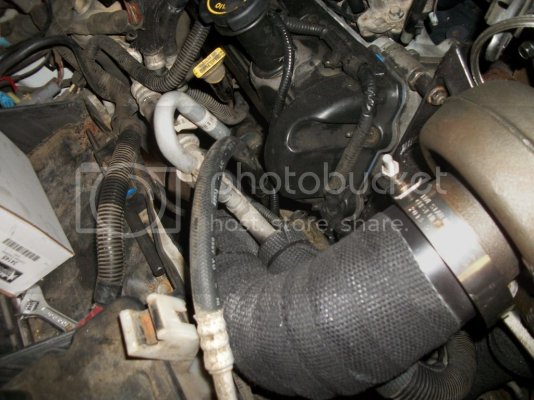

Here is a few pics of my progress and i will keep this thread updated through next week when i finish it up. The 98 i bought has rear heat/air so its going to make the downpipe awful fun!

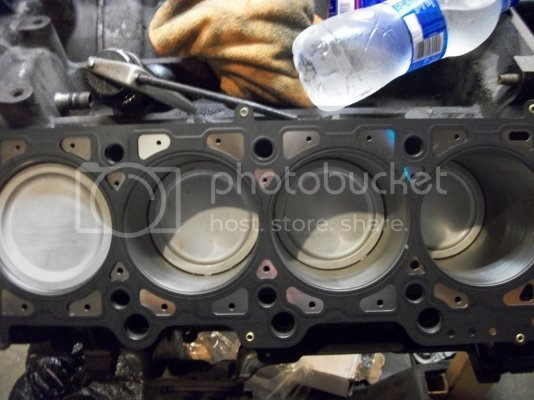

I managed to salvage the built trans i did for the 97 and the bottom end and most of the pipes on the hot side.

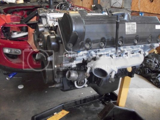

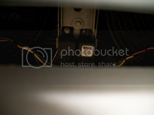

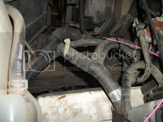

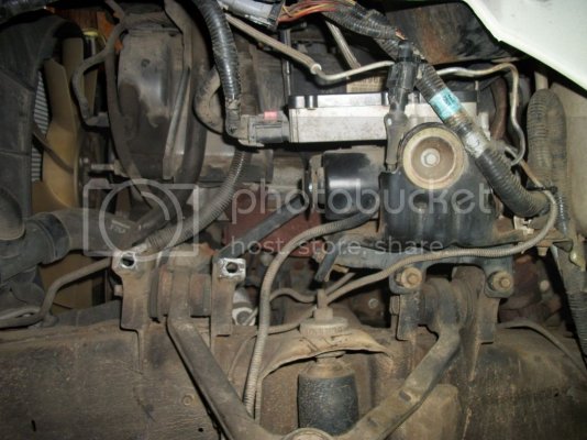

I started by moving the ABS( i just delete it on lighnings but the 4wd needs it for the GEM module) and doing the electric fans, mounting the intercooler(I am doing Air-Water).
In the pics you can see i also trimed the tops of the control arm mounts. A neccesity with the 4WD, Not neccesary with a 2wd.

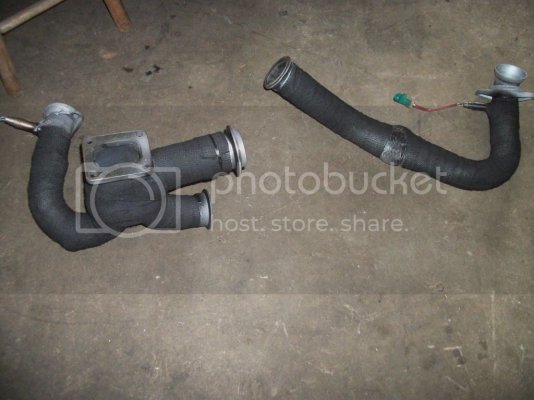

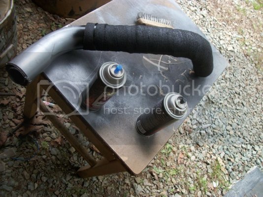

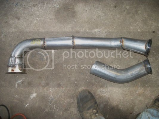

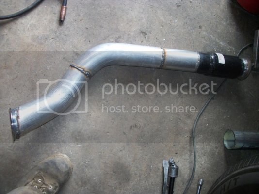

Driver side hotside pipe with flexjoint
Pass side hotside with wastegate flange and turbo flange

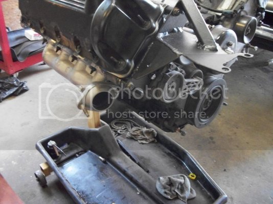

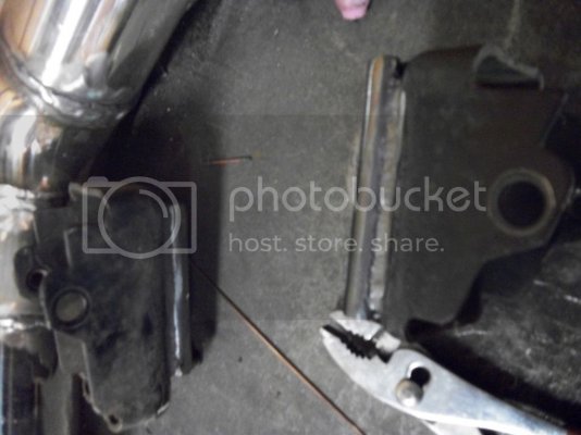

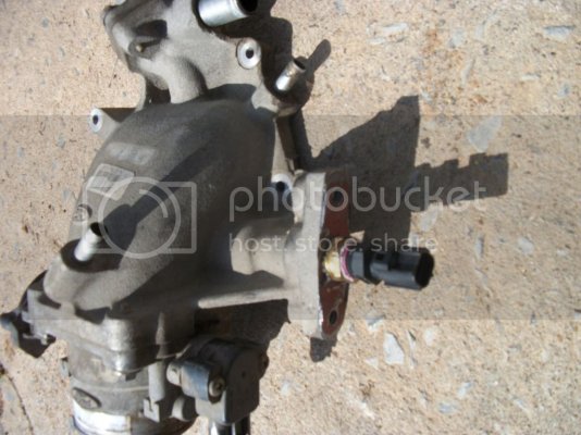

The manifolds are a stock 4.6 truck manifold flipped on the pass side, the driver side is a factory mustang 4.6 2v driver side manifold. I cut the egr tube and welded it shut.
Here i am getting ready to raise the engine

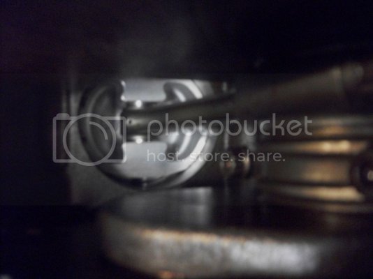

I have good bottom end parts and i worked the heads, If this was a stock motor the 440 would be all i was comfortable with.

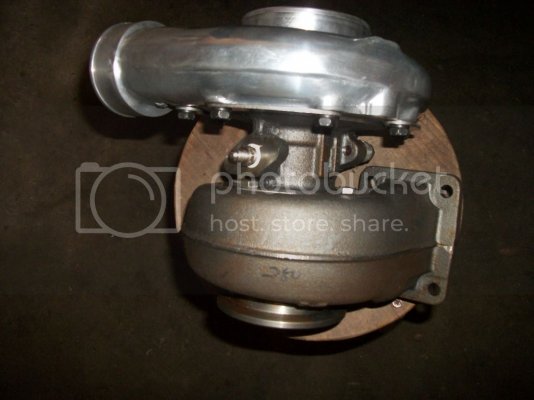

The turbo for this build will be a Borg Warner 67mm with a .91 Divided backside.

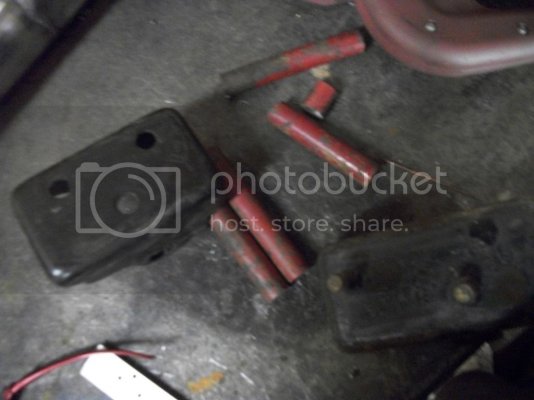

Here are the motor mounts complete, I had to slot the holes for the bolts and slide them up too, Just raising them makes the holes go inboard as well, so you have to slide em out, It makes putting the engine in a real JOY! I just used some bar stock I had laying around. On the last one i didnt figure this out until the motor was in the truck, so i just took some 3/8 plate and used the plasma to cut it out, lifted the engine with a jack and slid em under, Then i welded them to the frame and the mounts without taking anything off! This one looks a little cleaner though!
Put in some air bags as well for towing.
