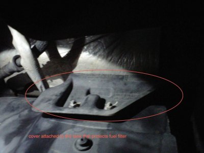

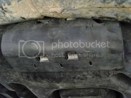

Finally did it this past weekend. I got a little bit of gas on myself, but overall, it wasn't that hard to change. I think I had more of a problem removing the black cover.
Here's some pix to help future noobs like myself find it easily.
What the cover looks like:
What the filter looks like in place and w/o the cover:
