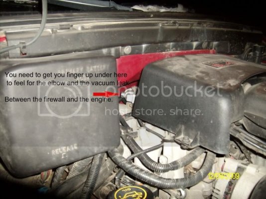

The first thing to check is your vacuum assembly. You most likely have crack or hole in the little rubber elbow that connects to the intake from the PCV valve on the right hand side of engine. Even the slightest crack will allow more air to be sucked into the engine causing a too lean mixture.
The PCV valve is in the right valve cover... which is on the left side when your facing the engine (passenger side). It's under a lot of other hoses so it is very hard to see.. The hose goes back from the valve, then toward the drivers side to attach to the back of the intake way back between the engine and the firewall very close to the top of the engine. The common faulty part is the rubber boot that connects the hose to the back of the intake.
The way I found it was to follow the hose back from the valve cover. I sat right on the engine shroud, and felt for the tube sticking out of the top rear of the valve cover on the passenger side of the engine. With the engine off, it pretty much just pulled out and went back in real easy. Then I just followed it with my hand the best I could ( with the motor now running so be careful!!) until I got back to the firewall, and it actually comes up from underneath the rear of the intake. . You can kinda reach your finger up under there to where it's connected, and feel and hear a definate shoosh sound when your finger goes over the hole or crack in the elbow.. You can't see it, but you can definatley trace it back by following that tube. You'll know it when you find it because your finger will plug the hole, and your truck will start running smooth again!!!
The part number for the entire vacuum assembly with the correct boot on it is - F85Z-6C324-AA probably around $30 -$40. Or you might be able to just replace the elbow itself. Either way, make sure if you do have the leak, to make sure you have the replacement part handy before you take off the old one, because it will crumble in your fingers!!
Hopefully you just saved a few $100, and a lot of frustration. I know I was pretty happy when I found this easy fix!! Good luck!!!

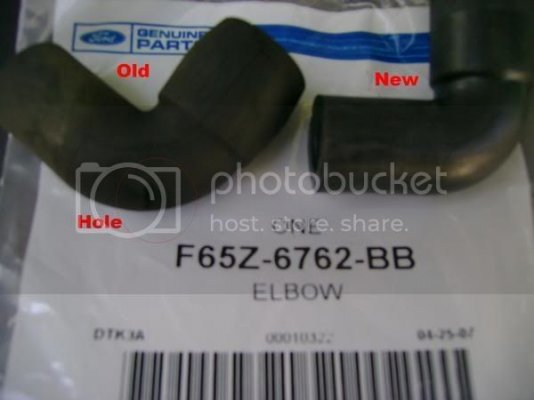

Thanks for the pot it came in very handy and saved me a lot of searching.
Just a quick question, is that part number in the picture is that just the elbow or for the entire assembly with the plastic tube too?
The pic is just the part number for the elbow.. The entire hose assembly part # is above it in bold. It is F85Z-6C324-AA .

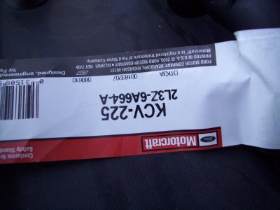

hey thanks for this great post... on mine it wore a hole where it expands over the fitting heres the updated part number F75Z-6C324-JA....its the elbow / hard line and PCV valve it was $39 after tax five minute install

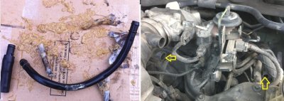

Thanks for the post...Helped me out a lot! I have a 1998 Expedition Eddie Baur 4x4 with a 5.4 ltr engine. After hearing a whistling sound coming from the engine area and a considerable rough idle I recognized it was a vacuum leak of some kind. I traced the sound to a ruptured boot attached to a hard rubber line- very much described in this post.
My truck required a replacement Ford Part # F75E-6C324-JB (see photo) The part is also identified as F75Z-6324-JB. The part comes in two versions - heated and non heated which is identified by the "JB" code at the end of the part number. Lucky for me I needed the non-heated version which was about $29.99 from the Ford Dealer...$20 cheaper than the heated version.
I have attached photos of the non-heated hose. From what I hear is a 10 minute or less install...I called Pepboys and they said it was an approximate 1/2 hour repair and quoted be $35 to put it on FYI. Thanks again
UPDATE: Pepboys mechanic said the Ford parts guy was wrong and I needed the heated hose which actually has a second hose connected at a Y-fitting. Oh well...also after the repair the idle still was rough and the engine dies when a/c is turned on. Next step is the idle air control valve (IACV) which was a $40 part. This is not difficult to repair however is located in the same tricky spot as the PCV hose which is toward the back of the engine. Just gonna have my local mechanic put it on for $25. Will update after install.
UPDATE: I replaced the vacuum hose and the truck actually improved a bit however the idle remains rough and when gearing up to about 15 to 30 mph the idle gets jerky. I had the mechanics do a system check for codes and sure enough the #2 and #6 cylinder coil pack needs replaced along with a new spark plug. So the sage continues. Will update...
