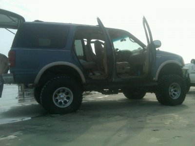

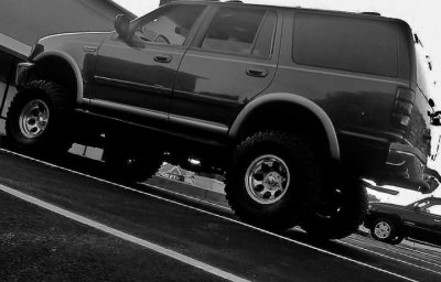

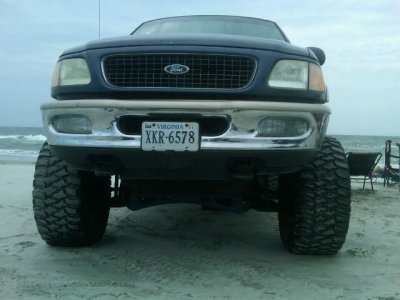

i posted about a month ago with questions about lifting a air ride eddie baur 4x4 expedition evidently nobodies done it ha or at least with a fabtech kit.
only bad's were
kit shocks on the front wouldnt match up with the front shock hoops
so i had to weld plates in 4" lower than the original shock hoop
the traction bars that mount to the tortion bar drop brackets and the second crossmember underneath the front differential were 8" short so i extended them
and the rear air bags to swap to coil's all i need were some upper coil spring isolators about 40 bucks on rock auto.com
will post more pics later but for now heres a few.

Thanks for all the compliments.
till this day i dont know why i didnt get 38's ha im kicking myself for it.
it didnt cost me anything ha did it myself.
well except youll need coil spring isolators some parts you dont have on air ride suspension.
and re gearing? um if i get 38's maybe 4.56's i dunno though they seem kinda drastic to me.
