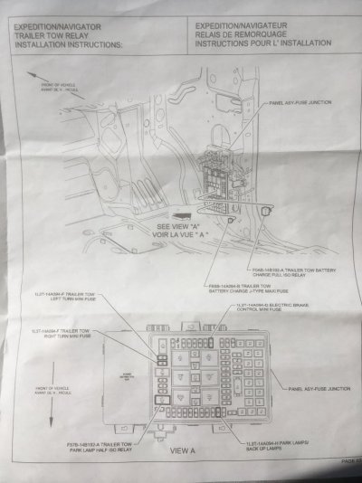

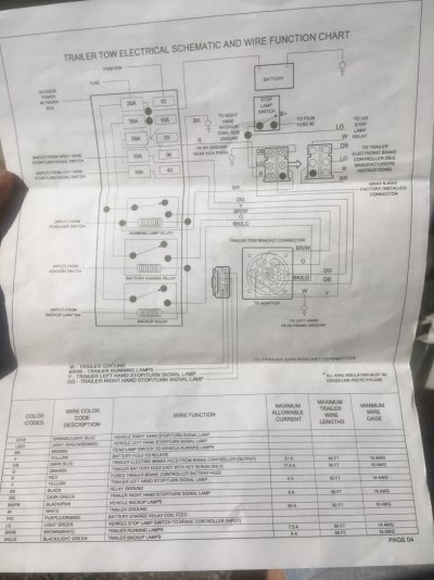

Following up on this, I ultimately passed on installing a direct DC to DC connection. Because, I discovered that the previous owner had purchased, but not installed, the dealer trailer brake connectors. SK-4L1T-15A416-AA
In the package was a 30 amp fuse and a relay - for charging the trailer house battery!
I installed these both according to the instructions and initially seemed to be getting ~8amps sent to trailer via 7 pin. My TT battery has a shunt installed and a charge monitor so I can view exactly what’s happening.
However, towing all day yesterday, little more than ~0.5 amp was being sent.
I know sometimes Ford requires you to do a special procedure to “recognize” that a trailer is being towed. Perhaps I did this without realizing it at first but did not do it yesterday.
Any thoughts on what the special trailer hook up dance is to send power?
06 Eddie Bauer.
