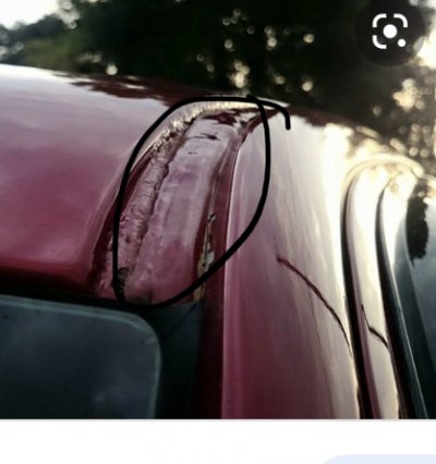

The water channels that run the length of the roof on the far outer edges are sealed with a really ****** squishy foam like sealant, id bet there’s a gap somewhere in that seal and water is getting under it and traveling downward to the A pillar and in through there. This area pictured below

@black_limited I have been looking at those and don't see any leaking but there may be a crack I can't see. Do you have any experience making a repair with that ****squishy foam like sealant?
neogenesis
Jul 27, 2022
Wa
An easy fix would be to run a even matched strip of black eternabond tape down the track. It will seal any water leakage and look good as well.
Fastcar
Dec 14, 2013
531
281
FL
You could always run a small bead of clear silicon down the seam.
