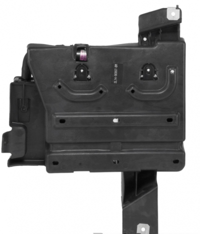

The hose is fairly large and one end is attached to a box sitting above the spare tire well! It has a four pronged connection on it but I cannot find where this is supposed to go! Any ideas would be extremely appreciated!
whtbronco
Nov 13, 2021
646
280
Winchester, VA
The only thing I can think of off hand is that it goes to the vapor canister. The vapor canister is mounted above the spare tire on top of a plate. Here's a pic of a replacement so you'll have an idea of what you're looking for.

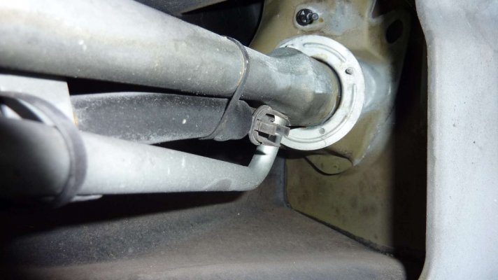

I recall going down this rabbit hole before and it's a vent hose. I don't remember exactly what for though. It was tapped or zip-tied against the filter hose, right?
