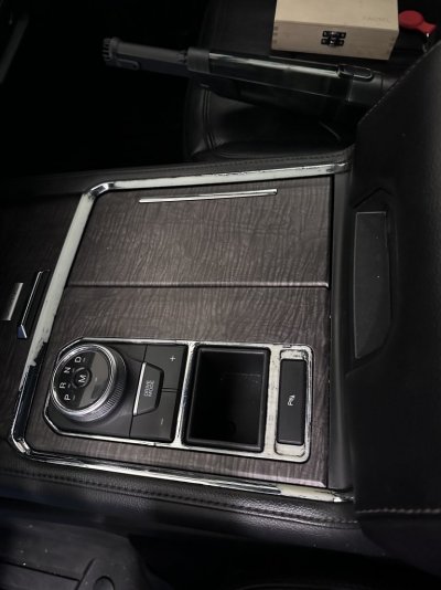

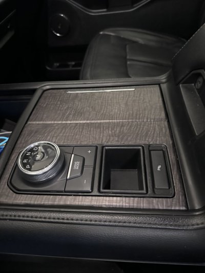

I had this issue on my 2018 Ford Expedition. I ended up using Vallejo acrylic black paint and brushed it on. I lightly sanded it before applying but honestly didn’t spent a ton of time. Painted right over some of the existing chrome because I didn’t want to be there all day.
Not perfect but looks better in my opinion. I also put Vallejo Matt varnish over it for added protection. Vallejo products are sold at craft stores like Hobby Lobby. Before/after photos attached.

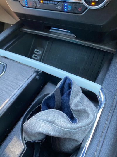

Wait till you put a drink in the cup holder and the bottom falls out. I just had to take it apart and put screws in it. The top of the console pops off easy. I might try the paint idea.
