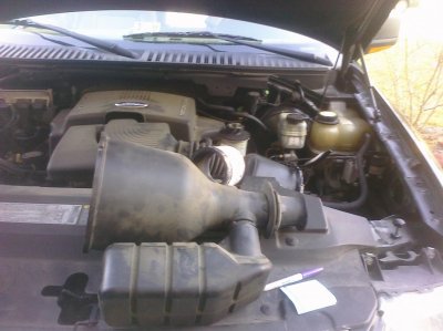

Got a question for you Daytoman. I have an 04 EB also and was contemplating the same mod. Did you totally cut the silencer(big plastic bubble off to the side) out of the equation? Just wondering before I do this.

I did. After I shoved the pvc pipe into the fender hole I started to put the coupler on and realized i couldn't fit both the silencer joint and the coupler into that space...SO I just ended up taking it off. In the picture you can see that the joint where the silencer comes into the main tube pulls apart from the air filter housing so I just took that off and fitted the rubber coupler onto the filter housing.
I'm not entirely sure what the silencer does since it didn't get any noisier. I've had it that way for almost a month now and no problem.

Thanks for the pic, that's exactly what it looks like. Just wasn't sure what to do. Going to do the mod this weekend, hopefully it will go well, will try to get some pics to show.
Good luck! It took me a lot longer than expected. Sanding the PVC pipe down took FOREVER and I used a a bench sander. I think my mistake was that I got a thick walled one thinking it would be stronger but I wasn't thinking. Because After I was done sanding the whole thing down parts of it was as thin as paper...and it still barely fit.
