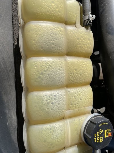

I encountered a coolant disappearing issue with my 2019 Expedition Max with 50,000 miles. I routinely check my fluids, and two weeks ago, I noticed the coolant reservoir was low and had to add about a quart of coolant. Today, I checked it again, and to my surprise, the reservoir was almost empty. I had to add at least half a gallon of coolant just to bring it up to the minimum line. There are no signs of coolant on the ground or in the oil. I did notice quite a bit of condensation in the coolant reservoir, please see attached picture, and I’m wondering if this is the culprit being a bad radiator cap? I’m honestly dumbfounded by this vehicle’s reliability—or lack thereof, I’ve had multiple issues.

I have condensation in my expansion tank, but no leakage or loss of fluid. It’s also impossible to take the cap off when cold. It needs to be a hot engine to allow the cap to come off without risking breaking it. Don’t know why. If you suspect the cap, just get on their cap.
Thanks. I’m able to get the cap off fine when cold however it’s one of the hardest caps I’ve encountered. Even if it was the cap, would that account for 1/2 gallon of coolant loss in 2 weeks?

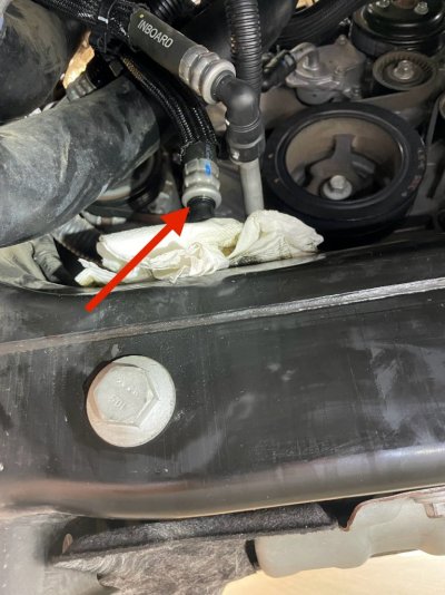

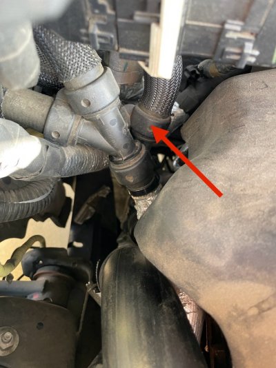

Found the leak not sure if it’s coming from one or two places, but this is the hose that has coolant dripping from it. The shot of underneath the vehicle is where the coolant is dripping to the ground. Not sure if that hose is leaking as well.

Thank you for the post. I went out this morning to inspect for leaks, just as look under the car I saw a drip on the ground. I got under it and traced it to the Y-shaped heater hoses to the firewall. They’re leaking quite a bit, I posted pics but it seems to be a very common issue. I guess I’m not shocked about cheap plastic parts but I don’t expect them to fail with 50kmi. Have a Toyota that’s almost 20 years old with 240kmi and I’ve never had to replace a hose or plastic part on the car. Guess they just don’t make them like they used to.
