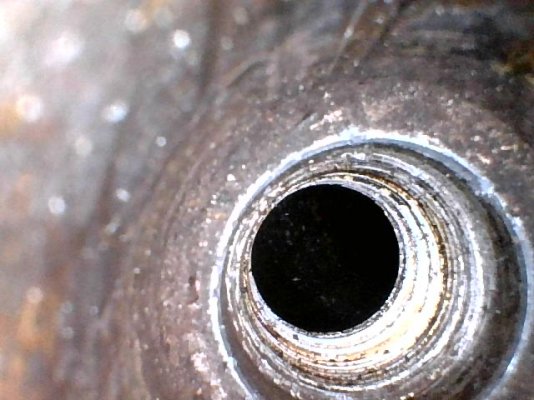

Just for fun, I ran my borescope into the hole to see what's up... the faint of heart should look away..
Oh the humanity! Those are some horrible threads. Notice the lack of ridges or anything that would hold decent torque. Poked into the cylinder and noticed this little gem:

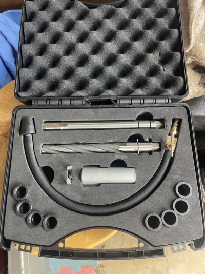

This is the kit I got:
Worked great with the exception of the air hose thing (more on that in later). You really can't tell from the pic, but the bore reamer, the tap, and the sleeves are massive. I hit my file attachment limit, so you are just going to have to use your imagination from here on.
I'll spare you the details but suffice it to say I followed the YouTube video on how to use the kit pretty much to that letter. My results were great. Kit worked as expected and I was able to ream out the holes, tap new threads, and insert the kit with ease. It was actually surprisingly easy. Couple things to note:
-The alignment sleeve and the air hose kit are invaluable. The sleeve makes sure the reamer is aligned correctly in the plug hole and the hose kit is there to make sure your valves are seated. So yea they really make the kit. The beefy sleeves and the fact that the kit essentially cuts all new threads into the head, not just the 4 measly threads that come from the factory, is what really sets this kit apart. You literally create all new threads, not just over tap the original ones like the cheap kits do.
-The cheap Chinese made air hose adapter for the leak down tool didn't fit a standard quick change adapter. No matter how hard I tried to fix it, it just wouldn't grab. A little modification with some air line fittings fixed that but it was a PITA. YMMV but mine didn't work... 4 out of 5 stars.
-I used compressed air to blow out the cylinder and a shop vac with a long piece of vacuum line attached to make sure I got all the shavings. You will create a PILE of shavings in the cylinder so it's important to get as much as possible out before starting the engine. A couple of small shavings left over isn't going to kill your engine (aluminum is softer than steel), but it's better safe than sorry.
-A borescope of some kind is a MUST. I used a scope that was meant for looking in walls that connects to my phone but it was free and worked fine. You can rent a scope at any auto store but you really do need one to check your work and to make sure you got most of the shavings.
Fix feels "solid", the insert threaded right into the hole, and torqued to 20ft-lbs easily.
So if you experience a blown-out plug, which is all too common on these engines, and/or you go to change your plugs and get a nasty surprise like I did, take heart in knowing that there is a quality, permanent fix out there for your engine that doesn't require replacing the head or your Expy.
