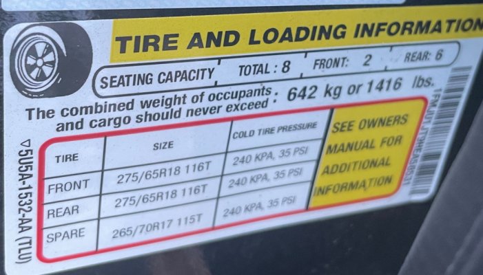

I've also hauled quite a bit of pavers in the hatch - anyone know what the safe interior payload limit is?
