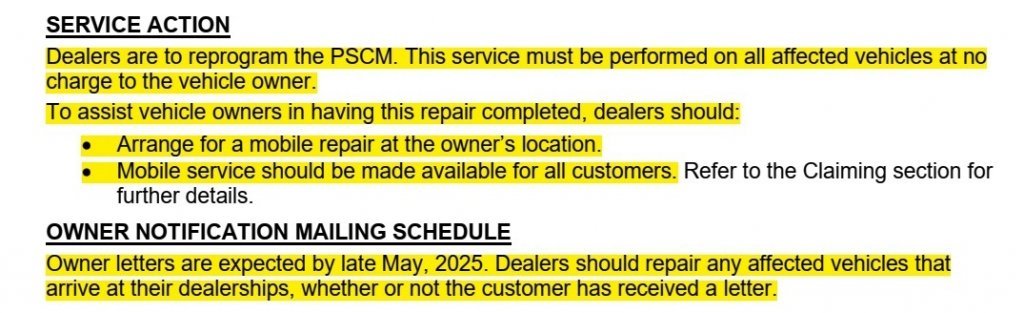

THIS POST WILL BE UPDATED.

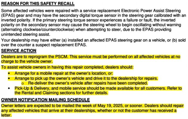

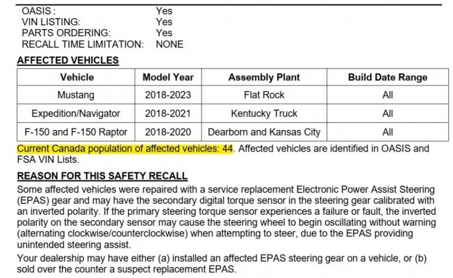

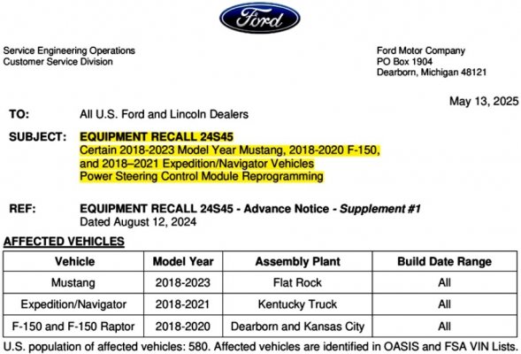

*** Advance Notice To Dealers ***
![Equipment Recall 24S45 - Advance Notice - 2018-2021 Expedition-Navigator - Service Part EPSAS ...jpg Equipment Recall 24S45 - Advance Notice - 2018-2021 Expedition-Navigator - Service Part EPSAS ...jpg](https://www.expeditionforum.com/data/attachments/79/79718-fa0ca1ad9a7fc49b9f2ff78c492b6b3c.jpg)

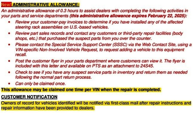

If your vehicle has received a Dealer-installed or Dealer Parts-Counter-sold EPAS steering gear replacement, and your vehicle has exhibited the above-described steering wheel behavior, it would be prudent to contact your Dealer and ask them to contact the SPECIAL SERVICE SUPPORT CENTER (SSSC) for direction toward repairing your vehicle.
![1720008799307.png 1720008799307.png](https://www.expeditionforum.com/data/attachments/79/79720-d39c9fc9d856d5bd647bc1f46f1de533.jpg)

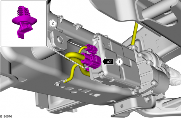

As a supplement on this topic, the Workshop Manual procedure for Steering Gear replacement is attached below as a PDF document...
