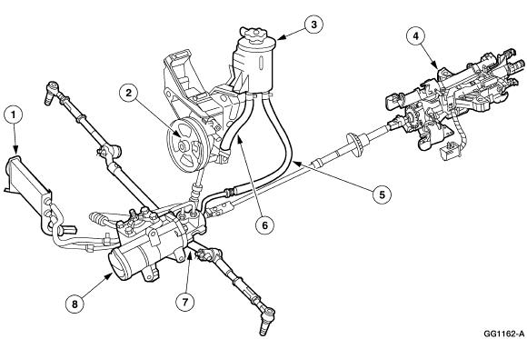

What needs to be replaced?
1 - Power Steering Fluid Cooler
2 - Power Steering Pump with EVO
3 - Power Steering Oil Reservoir
4 - Steering Column Assembly
5 - Power Steering Fluid Return Hose
6 - Power Steering Reservoir Pump Hose
7 - Steering Linkage Assembly
8 - Steering Gear
F
firefighter407
Oct 26, 2008
58
In the picture #8 and the shaft that goes between #4 and #8
