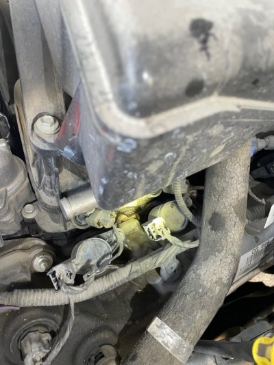

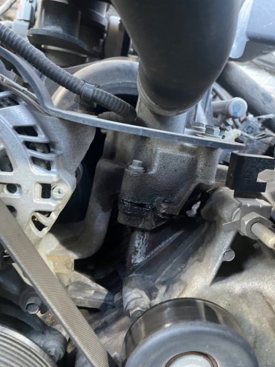

I have to add coolant every week on my 2014 exp 98k miles
Anyone know what is wrong?

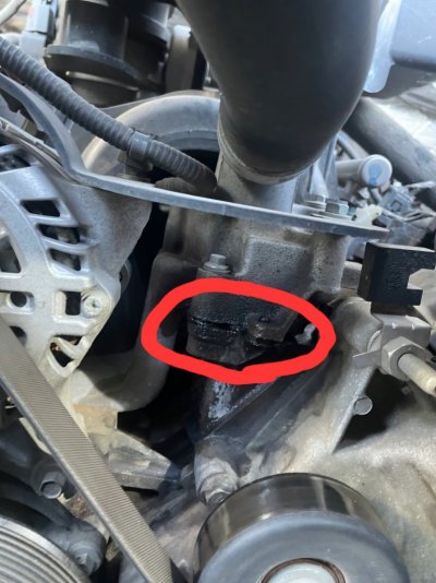

It's that gasket I circled, mine did the same thing, I believe it's called the coolant crossover pipe, you have to loosen the bolts on the intake manifold and then you can get that part up just enough to remove that gasket and replace it. It's a pack of 2 so you may want to replace the other side as well.

I would take a close look at that hose in the middle pic too (the one with the yellow stuff on top of the coil pack), as it looks like it could burst/crumble at any minute, even though it may or may not be leaking right now....
