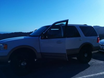

my 04 EB has the same setup. 3.5 Front - 2.5 Rear. I fitted 285/70-17 (equals 34,1 inch) on stock rims. No rubbing whatsoever, after alignment ride is firm and straight as an arrow.
Stock wheels because if tire cost, comfort and mostly i trust stock wheels more then some China handcrafted wheels with no certification. Its still a heavy truck and i don't want to take chances.
Stock 17 inch rims are extremely light and durable for what they are.
I didn't replace the Shocks yet, had to pay other bills first. 95k on her and next bigger expense is Bilstein shocks and complete rebuild of front and rear suspension.
