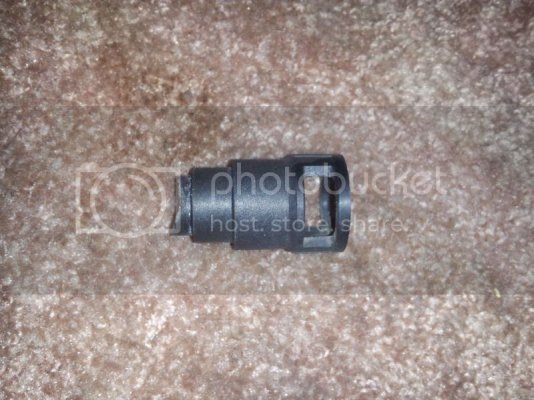

Unfortunately, when I was reaching around the intake to pull off the rubber boot, I bumped my heater hose and broke the plastic connection. It must have been very weak or brittle. So now I have another hose assembly to replace... unless I can figure out a way to use a hose clamp to attach it or something. Below is a pic of the broken part.
Anyway, back to the PCV valve assembly. I am having trouble reattaching the new rubber boot to the back of the intake. Is there some sort of trick that I am overlooking?

The only tricks I found to help with this were patience, perseverance and luck. I finally managed to reach mine from the drivers side and get enough pressure on it to connect it.
