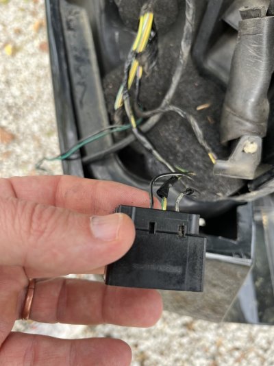

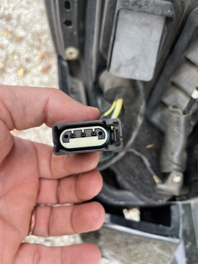

After hours of searching I can’t find this part. Anytime I think I do it says not compatible.
2017 Expedition
Left rear taillight. I have the socket that holds the bulb. I need this piece that plugs into the socket and delivers the juice.
Sometimes the light/blinker works. Sometimes it doesn’t. Replaced socket and bulb. This has to be culprit.
There are three wires to this connector.

It doesn't look too bad off. Did you put a test light on each terminal to test it ? If it really is bad you might end up go to a salvage yard and cutting out what you need.
Motorcraft Plug on Amazon

There’s nothing else it can be. Prefer to order a new one vs get another potentially bad one.
Plus I can test it and it can work. Then later it stops working. I can get it working, bundle it all up, it still works. Turn off truck. Turn on next day. Doesn't work. Or maybe it does work, then it quits working.
Somewhere a wire in that area is wonky so the only fix I can see is a new pigtail connector, but can't find the right one.

Did you go to a Ford part’s department with your VIN to see if the rear lamp harness is available (or a pigtail)?
