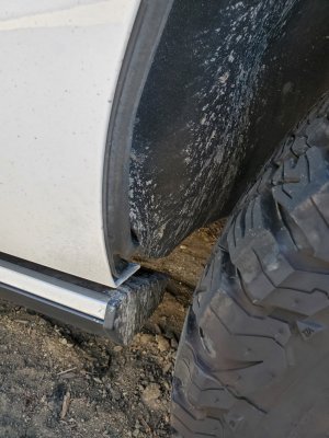

Welcome to the forum. There are a lot of threads on here about the ready lift. Use the search feature and you will be overwhelmed. Long threads and everyone has different likes, tastes and opinions. I have the RL and 35’s. I put the kit on almost new off the lot. Minor trimming at first then the springs settled a little and I started using my Expy on and off road. I have the front and rear of the front plastic trimmed, took the air damn off and trimmed the power steps 3” and I still will rub. In the rear if you stuff the tire into the fender well it will grab the carpet. 33’s seem to be the better option with a +18 offset. I have a +12 and going to a +18 should help. The width gets you more than the hight on the front.
