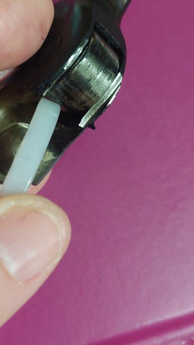

In February, At about 120,000 miles I experienced what I expected was a timing slippage. When we were listening for sounds there was suddenly a random loud ping/clunking noise in the right side of the motor. We shut it off & had it towed to a garage. Mechanic confirmed timing issue & $5000 & 3 weeks later I got it back & was driving home from shop when random loud ping started again. Mechanic said it was debris in catalytic converter system & it might blow itself out & wasn't a problem. Said we needed all new plugs & coils. We changed all 8 of each and it didn't fix noise. We pulled the valve cover & husband started wiggling the rockers & the #7 fell out into his hand. I've attached pic..it was pretty chewed up.
So it's been parked since March & due to weather & our 65 year old bodies, we finally got the cam out yesterday. I just ordered new cam & bolt, rockers & Lifters, so hopefully this weekend we can start reassembling!
