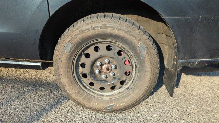

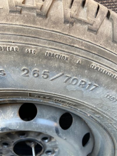

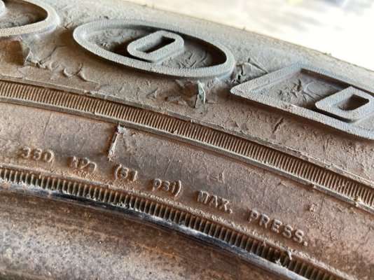

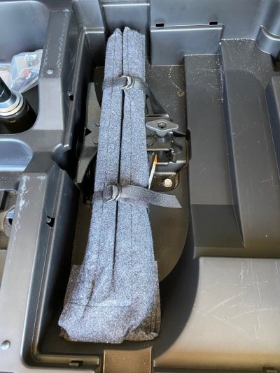

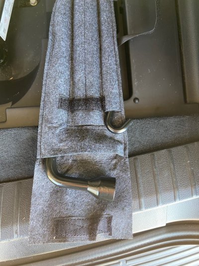

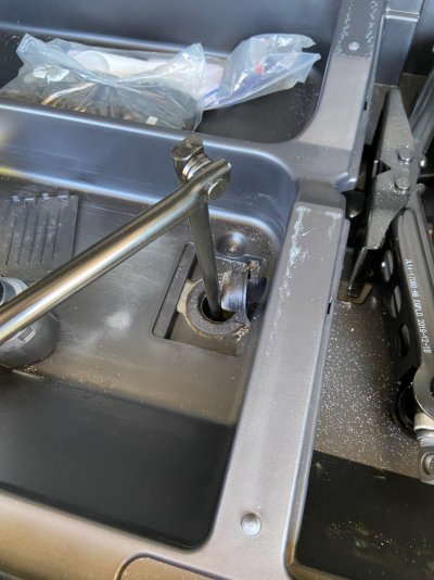

Last summer I got into the spare tire situation after owning our 2020 for 9 months. We were planning a road trip and I just wanted to get familiar with the tool and tire situation, so I lowered the wheel / tire to inspect and top-off the air. As you can see, our 2020 has 265 / 70 R 17 on steel wheel. I topped the air up to the max 51 psi. Just wish I had a better pic of the DOT date code because it looks quite weathered in these pics. Maybe next time.
BTW, if you do the math, the spare (265 / 70 R 17) is 0.3 in. shorter in diameter than the main (275 / 55 R 20). That gives a 0.96 in. shorter circumference. Less than 1 inch per rotation shouldn't affect ABS or Stability systems, I would think.
This post is a good reminder for all to become familiar with the emergency equipment and procedures of your vehicle.

Was your spare balanced? Mine wasn't.

Wow my spare is a different size... like Left Coast Geek said... mine is a 275/65r18 which is 32.07" (the stock tire is 32.10")
however your spare is only 31.61" which to me, is big enough difference not to drive far as its 1.3xx% smaller

My stock main tire is 275 / 55 R 20, which is 31.91 inches tall, not 32.10, so it's closer to the spare size of 31.61 inches. Maybe you have a different size main tire?
Still, I agree with your recommendation not to drive any farther than necessary on the spare, if ever needed.
