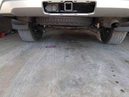

At first blush, the tire would only fit slanted nose down at the kind of angle where it would catch on nearly everything it tried to crawl over like a snowplow. That was a 'no go' so I asked about deflating it which was tried, buying more room. While it was even now, it still hung too low.

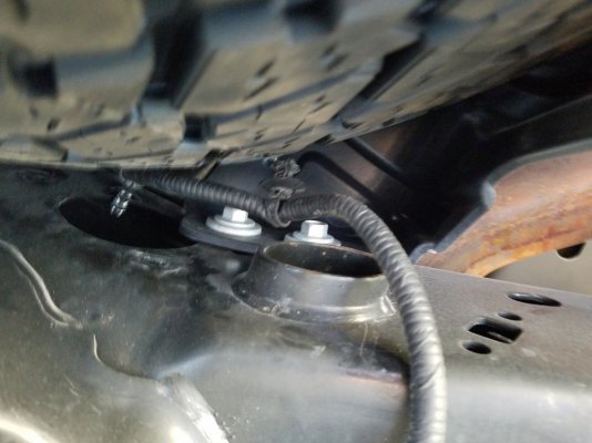

My 'mech finally got the idea to un-clip the electric brake module and this freed up enough room to get it wedged snugly up into the frame (pics below).
At this point, it is not necessary to do anything else with it as it is well secured at other points and resting on part of the tire and not at risk of rubbing on a sharp corner and shorting. This will be a point to keep and eye on, just in case. A few lashes of electrical tape maybe as needed, if needed.
AS FITTED
OLD Factory Goodyear 265/70-17 Spare:
NEW Nitto 295/70-18 Spare:
Tow Hitch:
Frame Side:
Cross member, facing front by diff:
Heat Shield:
Heat Shield:
Heat Shield:
I have only a slight concern for the bead on the deflated spare--I would of like a few pounds of air in their but considering (if you review my measurements when the tire is off the rim and un-inflated, you can see an aired tire grows almost .70 taller and wider). The 'mech thinks it will hold for many years w/o drying out. Besides, I know a few tricks ways to make a field expedient bead if necessary. At worst, I will always have a 100% matching tire to remount if necessary at the local "mule and fuel" even if far away from home.
Still, at next visit, I will engage him in a reattempt to fit it with maybe 5 PSI just for my peace of mind and some strips of electrical tape.

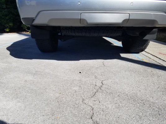

Adding the bigger spare does look like a slight bit of departure angle was lost--as the factory spare tucks better b/c it is thinner (10.5 inches) than even the already too thin stock tires (11 inches). So the fatter Nitto, even un-inflated is still a bit thicker.
Before:
After:
So yes, it appears the spare sits maybe a half/to full inch lower than the factory spare? (the spare seems to sit a lot lower when you actually get under the truck, as seen in the first pic)
