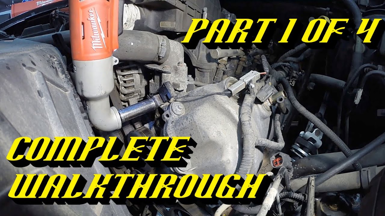

I have a first initial (and silly) question so i can begin doing the research and effort on my own. I found a great 4 part video on you tube here - YOUTUBE FORD ENGINE REPAIR
It states this video is for a ford 5.4L 3v Engine. But my 2005 expedition engine is a 5.4L V8. Aside from the differences in these engines, can anyone please confirm if this video walkthrough would work on my engine as well? or just the 3 valve. It seems a lot of people have had success following that video, and ive had a lot of success with my truck repairs via youtube help. I feel confident this video along with a lot of other reading up will get me to my goal. I just cannot find a solid answer on if this repair on the 5.4L 3v will work on the 5.4L V8. If this is stupid/obvious, im sorry. But this is my starting point.

I watched through the entire video, and although there were no parts that made me think "this is impossible", it simply became a time/ risk vs reward thing. Basically the entire engine comes apart and i could see me saying "i shouldve just spent the money at the mechanic"....Now, I did NOT consider a new engine until my friend mentioned it, and that might be a very reasonable option. I love this truck. The king ranch has such beautiful leather, interior, etc. The idea of putting roughly 4-6 K into this old truck as a repair sucks, but putting 4-6K into a new engine that will give this truck a few more years is not a bad option. I am going to look into the new engine option as my new first option. With that being said, any advice you may offer into what to look for now that im upgrading? What might you do in my position? Like I said its not like im flat broke, but I also enjoy NOT having a new monthly bill. If a few grand for a new engine will get me EVEN A FULL YEAR out of this truck id be content.. Just trying to kick this issue down the road until Im ready to spend money on something new. Thank you all for the input!

Checkout FordTechMakuloco on YouTube. I follow his channel. Have gained a wealth of information. He’s a prior Ford tech that branched out on his own; now has his own shop.
Look through his posts… I guarantee you there is something else you have an issue with that he has covered.
I saved this particular series (4 parts) of videos covering timing chain swaps for my old Eddie Bauer. Never did it because the daughter drives it now. Tried to tell her 305k miles is an impressive number to reach, but it won’t last. Was hoping to get my truck back once she’s able to get a new vehicle. It’s so ratted out now I don’t think I want it back.
Back to the topic at hand… I think you’ll find the information in the videos either inspirational, or discouraging, depending on your abilities, access to tools, and proper working environment.
