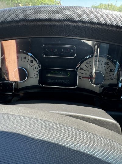

It does sound like it’s coming from inside the transmission. Although it seems to me more audible in the rear. The noise could just be traveling down the drive shaft. I have 282,000 miles.
