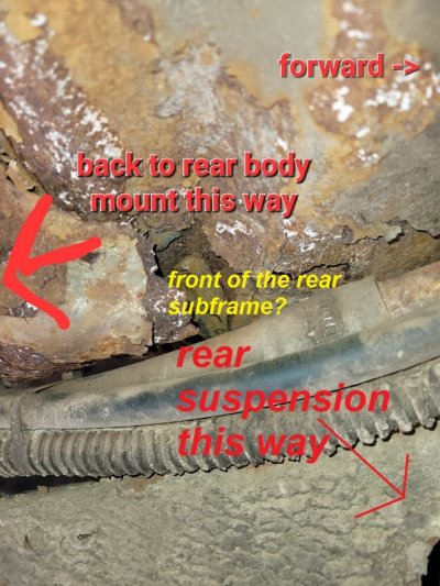

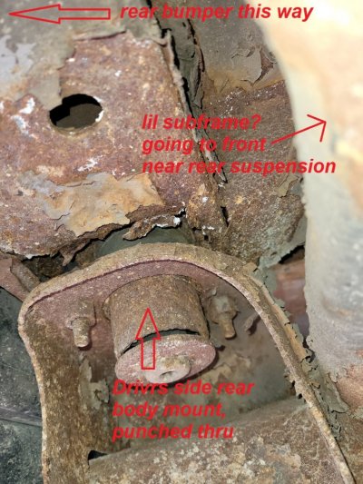

I'm looking at a 2008 this time. All the bells and whistles, priced fairly low for Canada....but for good reason. The rear subframe that is kinda welded up on the rear floor, that the rear most body mounts go into, is rusted away on one side....the other side is fine. But those very same "subframes?" on both sides are rusty too near their fronts (almost above rear suspension).
I understand i can probably get somebody to fabricate some kind of C-frame in there, but is there any aftermarket parts available instead for this replacement? What in the heck are they actually called? There is also a crossmember that goes the width of the truck, between the rear body
mounts, id likely change that while in there if i knew what part it was, etc.
I have not bought it yet, but for 5,000'ish Canadian, I figure its worth the repair! Will only be using it for camping basically. or am i wrong in this thinking?
Attaching pics. =)

IMHO it did not develop rust in just those areas shown in your pics. The entire frame and all connections to suspension and body components are most likely also compromised. You can probably find the parts you need using a combination of wrecking yards and NOS parts, but you will spend a lot of time and money. If it were me, I'd spend a little more and find one that is less needy.

I also looked up the frame cost both new and used, thinking that might be a possibility. As you said, new was around +/- $3000 and also found some used at +/- $850 or so. My concern with that route is you are not just looking at the frame, the body mounts and underside are shot and although you did not show pics of other components, I would bet suspension, hard lines (Brake, P/S, ETC) all have issues as well.
There are quite a few used Expy's in the northeast for sale now, none of them cheap, but that is the used car market these days. Some are very low mile SSVs (Police /Fire). You would of course need to get detailed underside pictures.

It's actually not the Main frame though. The main frame is perfect....with zero holes, its all thick and rugged just your typical surface rust you can wipe away with a finger nearly. I went thru that part with a fine tooth comb, stabbing everything with a screwdriver. LOL!
It's the part that the rear body mount contacts at the top of it (that subframe/crossmember) that attached to the floorboard.
