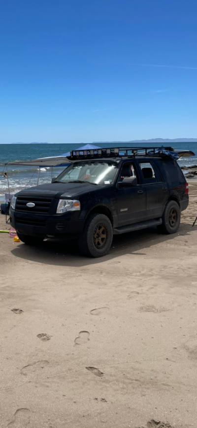

I offroad my 2008 pretty good (not rock crawl) its not the extended length version. I have never had an issue or gotten stuck. I have beat up my OEM running boards but I just patched then up.
Just have the readylift 3/2 spacer kit on OEM struts. Running method 18” wheels on cooper all terrains 295/70r18.
I use this for hunting and camping. For lighting I just added a bunch of amazon 4”square lights to the roof rack. So since you said you were into motorcycles then your handy and have tools, so just an idea that you can due.

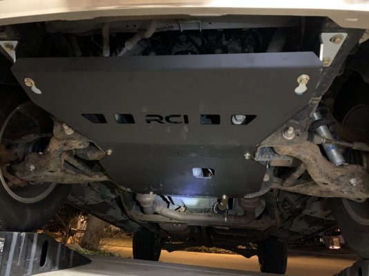

Just want to touch on that RCI skid plate package comment and fill you in on my experience with it. I managed to stumble across the full 10 gauge steel skid plate package for 09-14 F-150s on marketplace for $125 which was an absolute score but I had a few issues with it.
1) the transfer case skid plate absolutely will not fit. It interferes with the gas tank, does not reach the frame on the driver’s side and even if it did, you’d have to drill into the frame to mount it.
2) the rear engine skid plate made contact with the front diff (I do not have a dropped diff)
3) since the back end of the transmission skid plate didn’t have the transfer case skid plate spacing it further from the frame, it sat very close to the exhaust system. After driving for a few miles and heating it up, it expanded just enough to make contact and was vibrating against it.
4) idk if I the dude making them just did a bad job or what but once everything was on and hanging loosely and it was time to torque it all down the plates began interfering with each other and didn’t sit properly
Half of the fix for issue 2 and the full fix for issue 3: I grabbed some steel from the scrapyard and cut rectangular spacers for the all the cross member mounting points to lower the skid plates and make a little space
The other half of the fix for issue 2 and the full fix for issue 4: I drilled out the the oval bolt holes even further to elongate the oval and give it a little more play. I ground down the mounting slots deeper so there is more overlap between the plates where they meet.
I gotta say, if I paid full price for that I would not have been happy. I went on quite a journey of trial and error to make it fit right. Also, it was my first time doing any kind of metal work so I probably looked like a toddler operating an angle grinder.
If you’re used to doing that sort of work, I don’t think it would be too big of a deal. But just know, it is definitely not a plug and play situation.
Feel free to PM me about it for more info before dumping $900. I called RCI before buying it to get info about the fitment for the third gen and they had limited information which makes sense since they are more focused on F-150s plus its a bit older.
