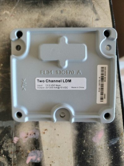

Not entirely true...
LEDs still use a driver similar to that of a ballast driver that HID headlamps use. Symptoms of a failing module is also similar to that of HID (flickering, noise, etc.)
See diagram for item 13C170 (FL3Z13C170B) in this case.

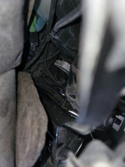

Yes I do have a 2018 Platinum Max. And this is the part that I'm talking about. It sits right under the headlight assembly. Some vehicles, not specifically this one, with bad LED strips, they just change this piece to fix the LED issue. I'm just here to see if anyone had that same issue and fix.
