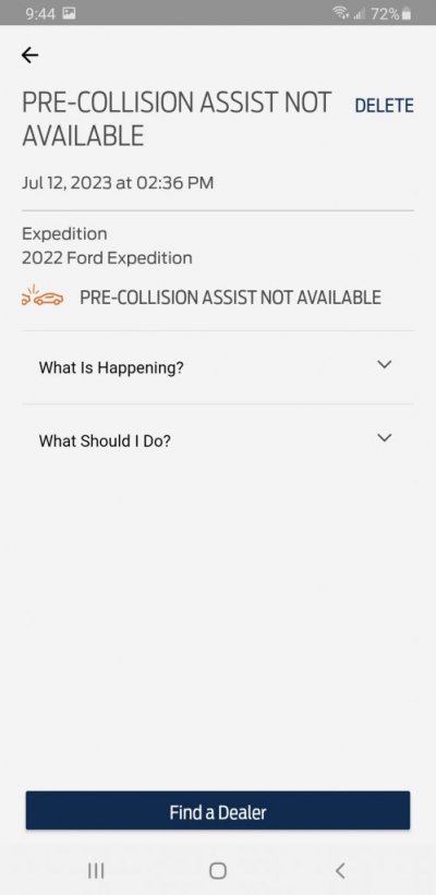

I'm having this exact issue on my 22 Expy Limited. Pre Collision Assist Not Available. No codes, but I did start getting the message sent to my Ford Pass app, so that helped to show it to the Service Advisor at the Ford Dealership.
It is an intermittent issue that doesn't usually last for more than 20 seconds at most. Sometimes triggers going over a bump, sometimes during a turn, sometimes when nothing apparently is going on. Sometimes it shows the 'Pre Collision Assist Fault', often it just triggers the chime that something is wrong, but no actual warning comes up. I think this is because the fault lasts so short the system doesn't have time to show the fault on the screen. I've driven 40 mins without it triggering, I've driven for 5 mins and it triggers a dozen or so times. No real rhyme or reason.
I'm concerned it's going to be a strange electrical gremlin that won't be easily solved. I dropped it off at the dealer last Thursday and haven't heard anything yet. They didn't act as if it was something they could get to right away. I did get a loaner so not all that bad.
