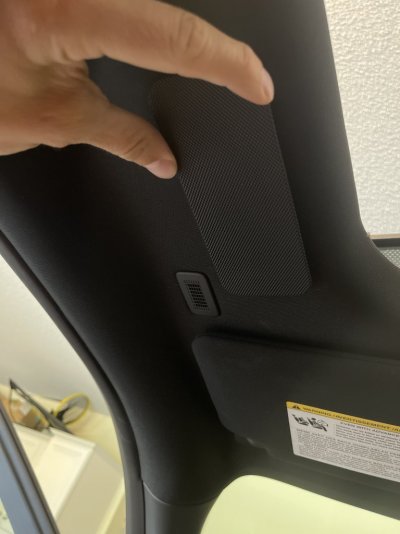

Hello,

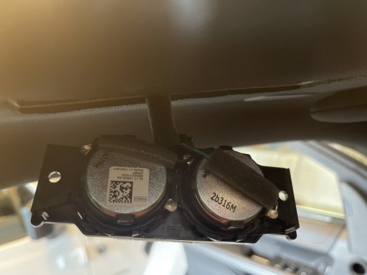

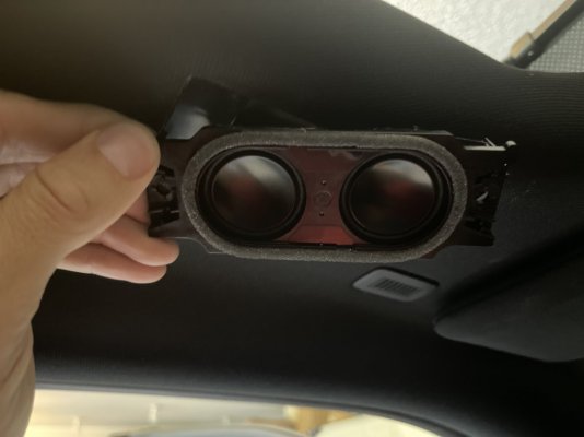

I recently purchased a 2023 platinum with active noise cancellation. I have some hearing issues and unfortunately anc via headphones has always bothered my ears so I don’t use them. I hadn’t given any thought to this being a problem on a vehicle until after purchasing my expedition and I believe it’s after a few days of driving it’s having a negative impact on my hearing and I would like to disable. I understand the three routes would be to either disconnect the microphones or use forscan or possibly ask the dealership to disable. My first question is to help identify which “speakers” are actually the microphones for anc in this 2023 expedition. There are four larger rectangle speakers/mics above front seats and middle seats as well as one smaller mic above driver seat and above third row in the middle. My assumption is that the 4 larger speakers/mics are the acn mics. I got access to them and unfortunately the wires are suatered so it’s not as simple as disconnecting. Any advice?
In the picture I’m holding the bigger speaker/mic for reference as I had already taken to off to access the inside. Also including a picture of the hardware uner the speaker/mic.

rd618
Nov 1, 2021
682
322
new york
the best way to ensure the system is off is to disable it via forscan.
removing mics might help it not read the noise levels, but remove the wrong ones and your in-car calling experience will degrade.
