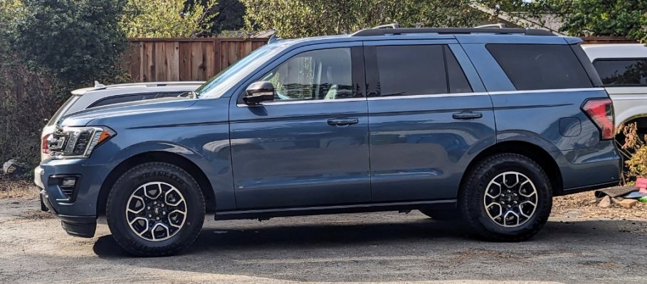

My 2019 Limited "Stealth" came with 22's, and I'm wanting all terrain tires for occasional off road adventures, so I swapped them for some new F150 18's takeoffs. Can't say anything that much about the mediocre Goodyear tires on them, but I immediately noticed the difference in the ride smoothness around town, and on the highway. The 22's were 'busy' all the time. The 18's use 35 PSI instead of the 39PSI of the 22's, and seem plenty planted, and my few short tows so far, they've done very well. In 2 weeks I'm leaving on an 8000 mile road trip, so I'll have more to say when I get back.
Before I bought this Expedition I test drove a bunch, many had 22's (one had 24's, EEEK!), and the 22's that didn't have CCDS, the ride was really awful, the CCDS made it not nearly as bad, but still harsh on rough spots, railroad tracks, etc. The 18's are just much smoother. Once I wear these Goodyears down some I'm planning on mounting BF Goodrich All Terrain KO2's in 276/65R18

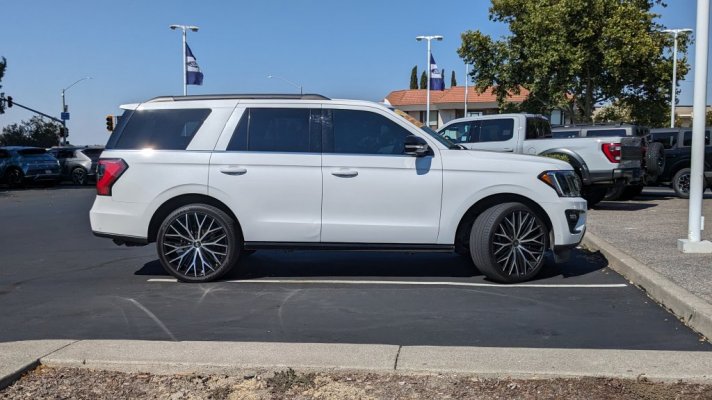

rando 2020 Expedition with 24's... These things rode unbelievably bad, this Expy was off a business lease, and the tire dates suggested the tires had been mounted when it was brand new... it had all kinda steering shimmy like the front end joints were hammered. Those are $2500 each Lexani wheels when I looked them up, plus I dunno what for the Neoterra 305/35ZR24 XL tires.
