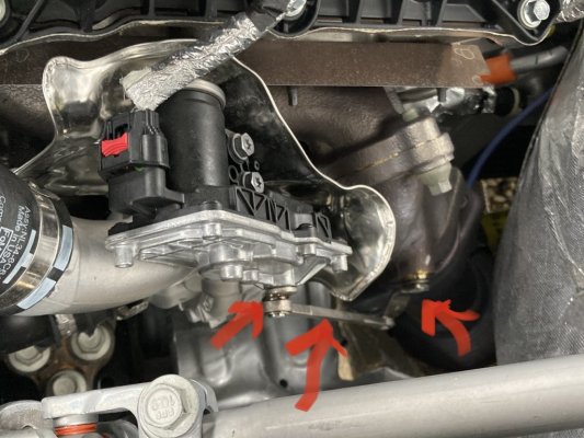

Suspecting it’s not electrical. Even though it sounds like a beep and is always the same quick beep (never different durations) it sounds like it’s coming from the drivers side turbo. There’s a linkage on the assembly and whenever it starts to move that’s when the beep (sounds like a chirp from here) happens.

is yours louder when you pop your hood and have someone tap the pedal? I thought mine was electronic too but when I went searching it’s definitely coming from the drivers side turbo’s wastgate? linkage, could be bushing squeal or exhaust whistle but definitely coming from there for me and yeah it’s not the distinct turbo spool and whine sound.
