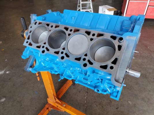

I'm in the process of building up a 5.4 3V before my current one dies (hopefully). Just wanted to share what I've done and found out so far and see what options others are doing in my situation. I've got a few minor upgrades in mind to help make this engine a little more "bulletproof" if that's even a possibility. I know there are a few well known weaknesses on the Triton that can take it out of service very quickly. I talked to some cylinder head shops who said that the valve train is actually the weakest part of the engine and can easily cause a major loss in oil pressure too.
My driver that's about to fail is a 2008 5.4 3V. It broke a rocker and ruined the cam recently, which resulted in metal in the oil and now loss of oil pressure, filter keeps filling with metal too. I bought a 2003 5.4 2V from an F250 SD in the salvage yard. I just need the short block and ordered a set of rebuilt heads.
I tore down the block and found it has a Forged crank P/N F75E-A17G. Also has the markings "WF 2951" which is the identifier for "Woodhaven Forge" that built it. I'm really glad I got one with the forged crank, just more peace of mind. The bearings looked almost perfect aside from one with a minor line grooved in it. The pistons were totally trashed though, oil rings and 2nd rings were all completely burnt and seized. It looks like it never even broke in, not even enough wear on any part of the cylinders to wear off the cross hatching.
I've been putting it together with new bearings and pistons/rods etc. So far all the measurements are very close to the tightest limits for the bearings and pistons/cylinders. The main and rods clearances are about .0015" with the range being .001-.0026".
The mods I'm planning on doing are all mainly with the oil system aside from the cam upgrade too. There's a kit that adds an oil pressure line between the heads. It's supposed to ensure that both heads, cams etc always have the right amount of oil pressure. Apparently there's a small oil orifice somewhere that can easily clog and block oil from the cam/head. They claim this balance hose will continue supplying the same normal amount of oil and eliminate the chance of that oil passage causing an engine failure. Cylinder oil Mod. I'm installing a normal oil pressure gauge and oil temp gauge too, just don't know where to mount inside the truck without it looking rigged.
Also I'd like to use the Ford oil cooler that adapts to the oil filter housing but I don't know how to hook it up to the Expedition's cooling system. On the F250 there were two hoses tee'd into the lower radiator hose that went to the cooler at the filter. I don't see any suppliers that make one for the 08 Expedition.
The cam upgrade is a Comp Cams one P/N 127050, which doesn't require new springs. It's purpose is really to increase torque for towing my boat. I also am keeping my VCT's locked out That's another mod to prevent future failures in the valve train. The engine shops all said to eliminate the VCT and combined with this cam I'll gain more power in the daily driver range. On a dyno it will lose a few hundred RPM at redline and at peak lose a few HP.
On the oil pump I just ordered a Melling High Volume pump, this should really make sure there's not another oil related issue. Also using stainless exhaust manifold studs. I've had plenty of trouble with them on past trucks.
Anyone have ideas on things to do while assembling? Any little tricks or mods to make it more reliable would be awesome.

So I have a dilemma that I'm not sure how I'm gonna handle on this buildup. The older block has one knock sensor mount. The new 08 3V's use 2 knock sensors. There's no where to mount two of them, I'm not going to drill and tap threads into the block. I've seen some other vehicles that have a history of overly sensitive knock sensors, and they have a mod where they unbolt them and secure out of the way, so they're unused. Then you're on your own listening for detonation.
In this case my first thought is going to be to piggy back the two sensors in the same location. May not work though because the intake sits very close and may not be enough clearance. Other thought is to install one sensor, and leave the other one wired up but secured out of the way where it's not hitting anything metal. I'm thinking these sensors signal is basically on or off, and don't constantly transmit a wide range of data to control the timing. If so, I think the second option should work out fine.
ANyone have thoughts on this or seen it before?
