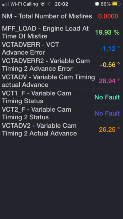

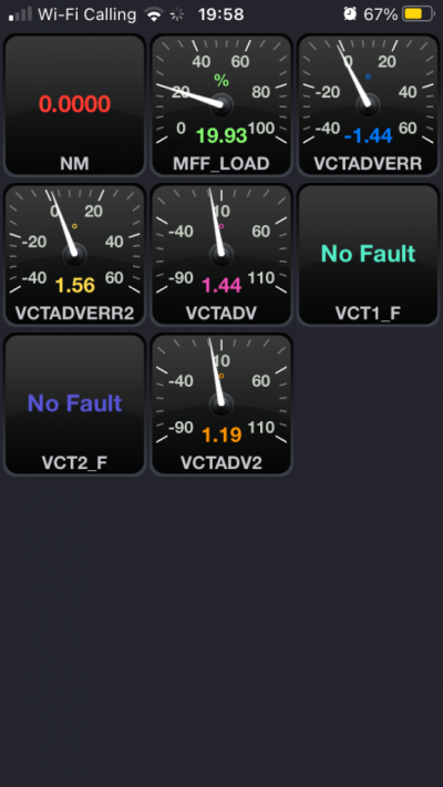

I'll second whtbronco and ManUpOrShutUp's recommendations. In addition, with these engines and their age and you have an '06 3V (like me), it's so important to get powertrain data in real time or logged from the PCM. ForScan Lite runs on a pad or phone and works nicely with a bluetooth OBD adapter like OBDLink MX+. I'd be interested in your misfire count ("NM") especially. I use it a second set of "gauges" on the iPhone while driving, looking at parameters such as VVT operation (advance degrees, error, solenoid duty cycle), misfile count and a host of others. Back to your issue, is the popping an internal engine sound, or like a backfire through the intake or exhaust?

Our ‘06s are rev limited to about 3K RPM in neutral and park. I see 0 or 1 misfires counted per drive, with the lone misfire happening on startup, best I can tell. Yes, you can see the misfire count in real time. I’m not sure if ForScan Lite can break it down by cylinder. I’ve never used the full ForScan software for computers, but know it has more capabilities.

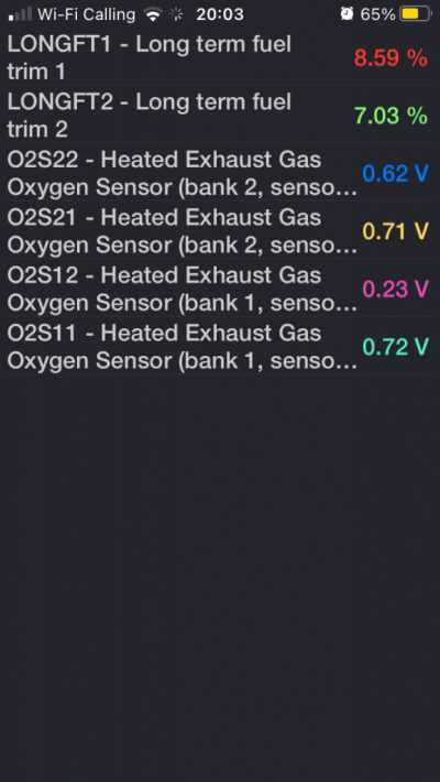

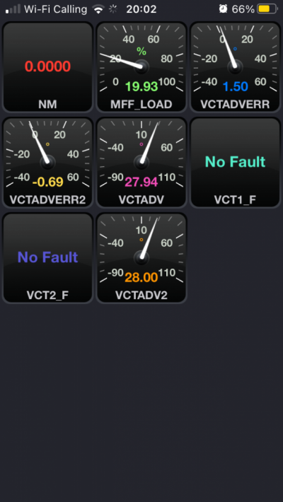

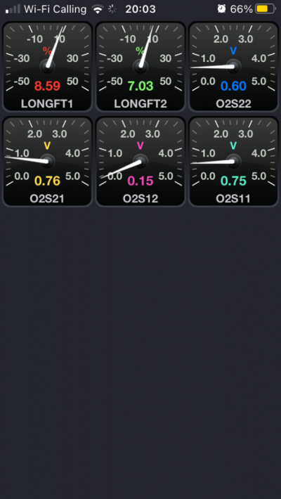

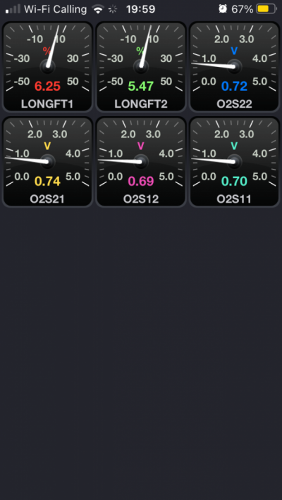

I did some driving this evening with an OBDlink MX+ and Forscan lite running.
Recorded 5 misfires heading to the store. 1 on the return trip.
Recorded at 2750 rpm and 20% load.
I think the popping noise sound might be an exhaust manifold leak. It occurs at a rate matching rpms, but only when the engine is reading ~55-80% load. Sounds like a helicopter, if that makes sense, at 80% load.
I can’t replicate the sound in park or power braking, only in that high load range.
When I’ve had exhaust leaks in previous vehicles - you and the neighbors knew it. So I’m confused.
