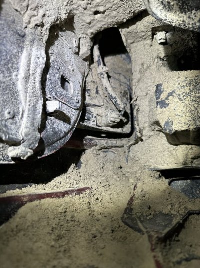

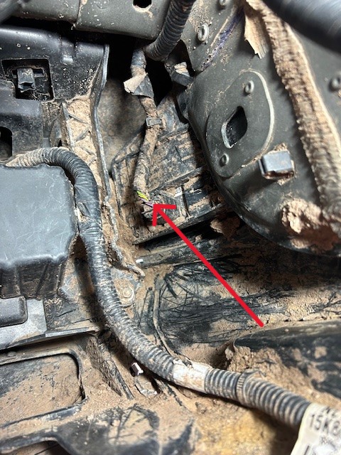

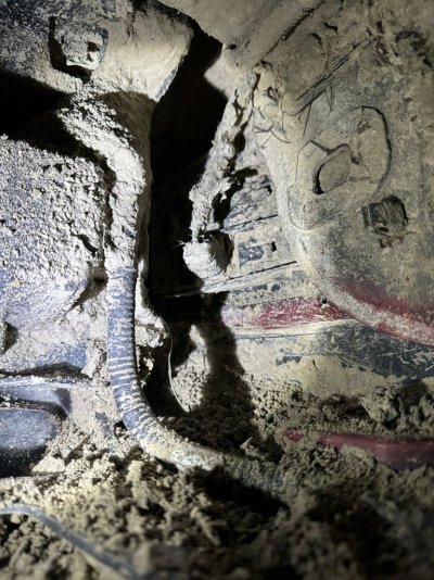

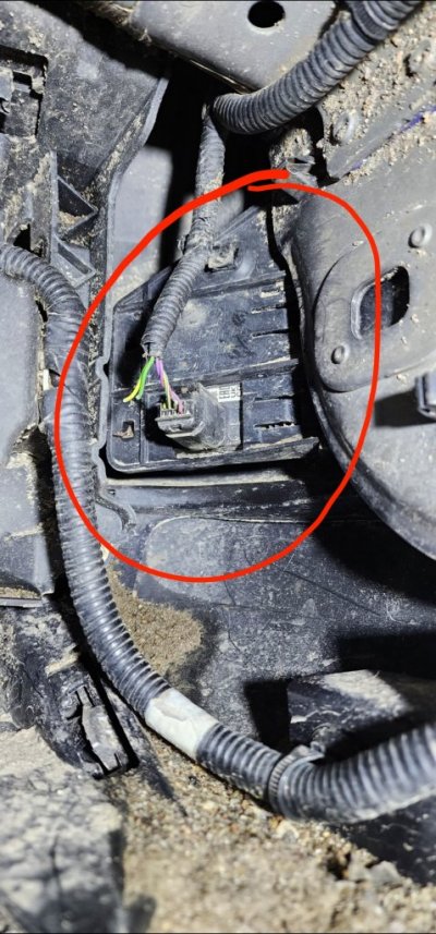

OK, I fixed the problem. Was built up mud between the radar sensor modules and the rear fascia. Pretty poor design in my humble opinion. The sensors are mounted about 1.5inches away from the surface of the fascia. They are inline with the rear tire. So any mud thrown by the tires goes directly up onto and behind the sensors (see pics).

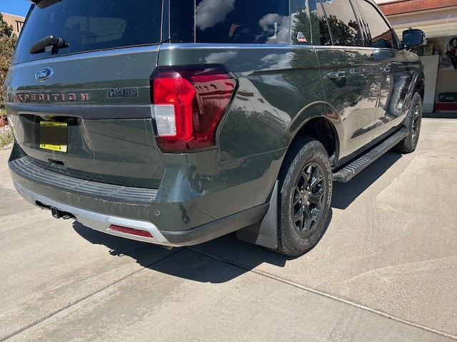

Luckily I have a lift so I was able to get the mud out from behind the sensors with a screwdriver. Then took it outside and gave i a rinse with the hose. Everything works fine now. I live on a dirt road. I expect now I will have this issue every time it rains. I did order a set of rear mud flaps from Weathertech today. Hopefully that will help.

* The real permanent fix is the Weather Tech mud flaps. This is the point I wanted to emphasize because if you don't install something like this this problem will continue to repeat. The flaps are super easy to install, look stock and most importantly do stop the mud and debris from getting stuck back there. I seriously don't know why Ford did not include these by default. Such a simple fix for this dumb problem. I have not had a single issue since purchasing them and I used to see this error almost every time I drove.
