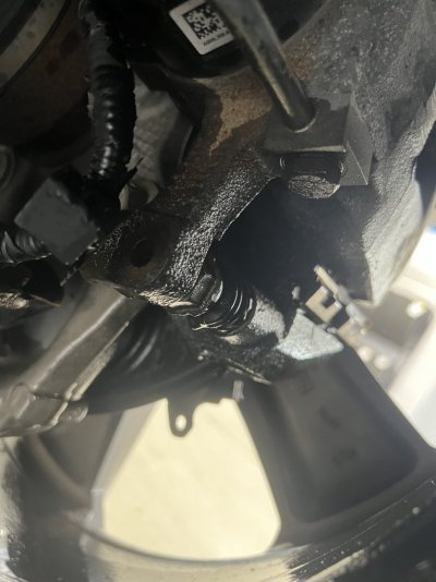

Out today about 10 miles from home and the brake pedal was gradually going all the way to the floor. Little bit after that my wife hears something scrapping and then sees something come off the vehicle and hit the curb. I go up about 2 blocks and turn off where I can stop and see that my RH rear wheel and brake assy is soaked if fluid and dripping. We start back home very cautiously and we see the part that come off. It was a caliper piston. Ive been doing brake jobs for people and family since high school. Never saw anything like this. Nobody has touched the brakes since it was built. All Factory. Got to the dealer and they were just shaking their heads. They never seen that happen either ever. Anyway here is a picture. Looks like the caliper bottom bolt or nut broke off for the slider pin. Top is fine. It's under an extended warranty so this should all be covered. Tomorrow I'll find out more.

As long as you havent had your calipers painted (by anyone other than Ford) they should cover under warranty.

You're missing a guide pin bolt on the back, too. Wonder if something smashed against it hard enough to take out that bolt and damage the caliper housing.

I know someone who had the same thing happen to them. The pin worked its way out( after a brake job) and the caliper shifted up. When they hit the brakes the brake piston blew out and they lost all brakes. What sucks is you don't have an emergency brake pedal to push down.
