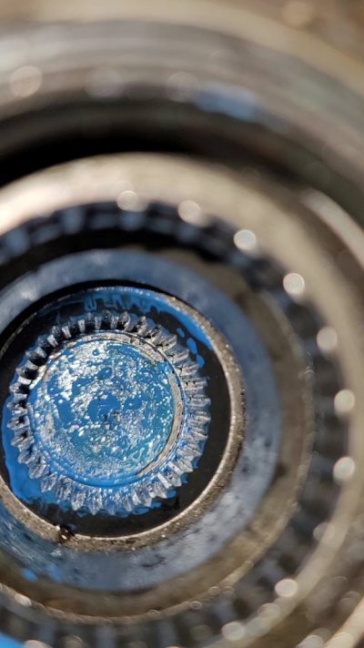

Here is what we're looking at. We suspected the CV axle was butting up against something inside the differential, so we used a paint pen and put paint on the end of it to see. Sure enough, it's hitting something that's held in place with a lock ring.
(Yes, he used a bit too much paint)
I'm not really familiar with differentials, so my questions are:
1. What is it hitting (is not the end of the other axle),
2. Why is it preventing the CV axle from seating, and
3. How do we correct this?

Update 3
Apparently that piece in the above pic is the end of the old CV axle, which snapped off at the ring...which is also inside, doing it's job.
Now my question is: Does anyone have any tips or personal experience removing a broken CV axle from inside the differential? I've searched Google, saw some ingenious ways to pull it out, but we don't have a welder, air compressor, etc. I'm basically having to MacGuyver this thing.

He doesn't have a choice. The housing will have to come out and there may be a Differential side gear change needed!
There was a TSB on this that I read way back but I can't seem to find it now! This is Likely one of the early builds(Built before the middle of March 03 Referred to in TSB) that had a problem with the C ring groove both not having a radius in the axle groove and missing a small chamfer on the Side Gear splines and a machining burr on both the side gear splines and the Axel Splines! The chamfer and the radius were to compress the C ring when the force from the axle removal tool forced the axle out of the side gear! These Machining mistakes would cause the Axel to be difficult if not impossible to remove without removing the complete housing and disassembling it!
I have not heard of the Axel end breaking at the C ring grove however it is possible if the inside diameter of the groove was not machined with a radius to prevent a crack starting from the C ring groove and progressing across the axle end! The TSB I mentioned only referred to axles that could not be removed with the normal removal methods!
The shaft you removed would be missing the end from the groove out and from your Picture it looks like there is a piece of the original C ring in the Side gear spline and it could very well be a Piece of an axel beyond that! In normal axel removal you would see the sipider gear cross shaft and in locking differentials quite likely a little bit of the S Spring visible and no piece of the C Ring! It should be open right into the center of the differential!
Bad News I know but one way or another that Differential housing is coming out!
