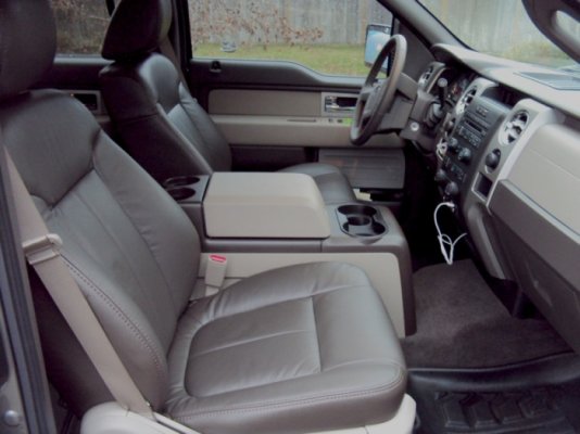

Personally if I had an SSV with a column shifter, I'd do a Navigator 2nd row console, or an F150 center console w/o flow-thru shifter:
