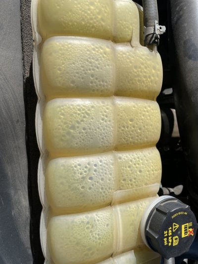

Looks like it's dripping from a Y shaped hose on the passenger side of the engine... I'm hoping I can nurse it for another week and got an appointment at a Ford dealer in Phoenix AZ next week.
