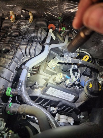

For those of you who had valve cover gaskets replaced I am in the same boat. But the driver side valve cover is said to be on national back order. And my issue does coincide with the cam phaser repair.
Both sides were leaking. I was doing an oil change and find oil under the engine cover and had been smelling burnt coolant.
Just got it back last week but they only temp fixed the driver valve cover waiting on back ordered gasket.
Mine is leaking in the same exact place as yours. I can see a hairline fracture on my cover on the shoulder just below the bolt where the oil pools (right where your light is shining in the first pic). I did have my cam phasers replaced (~20k miles ago).
