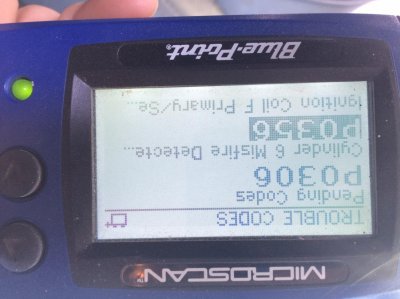

Ok big update! Sorry it's been a couple months but I figured out what was wrong. Did this back at the end of November. I pulled out my volt meter and started checking wire to see if I had a short or broken wire in the harness.
Well problem was a wire was broken. I don't know how it happened but I traced it to the signal wire of cylinder 6. The power wire was fine. I fixed it and it works great now.
Only other problem I had since, was a coil going out on cylinder 8. Did a change and it's running good now.
