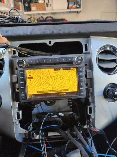

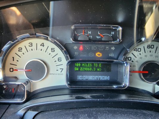

So the truck wouldn't let me change the zones or calibrate it. So after a few hours of good and YouTube. The fix was to plug back in the factory radio, then also unplug the rear view mirror. Once I did both I got back the options to change the zone and to calibrate. 20230120_101427.jpg20230120_101436.jpg
