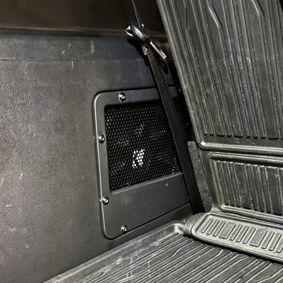

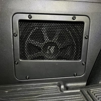

I’m planning to add the oem subwoofer and D pillar speakers to my XLT, but I needed a custom grill to cover the storage cubby opening.
I couldn’t find any perforated plastic sheets for a reasonable cost, so I ended up buying a universal subwoofer grill. I cut it down to size and sandwiched it behind the cubby trim with some m6 u nuts and machine screws. It’s not perfect, but I think it turned out ok. Hopefully it doesn’t rattle once the sub is installed.

Nice Work - Has an oe look

Great job. Looks factory. Use rubber washers between the metal clip and metal grille if it rattles.

Here’s an update with the sub installed. Sounds great and no rattling!

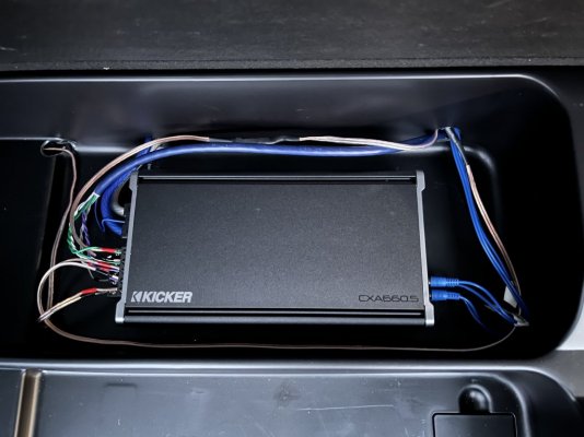

How did you were sub into radio? Did you intercept signal from driver rear speaker and where is amp at?

I have a 5 channel amp under the rear storage area. The subwoofer signal is fed by the front speakers. The rears have low frequencies filtered out, from what I’ve read on the interwebs. (I tried it both ways and the front signal definitely seemed to give deeper bass)
I added D pillar speakers as well running in parallel with the doors.
