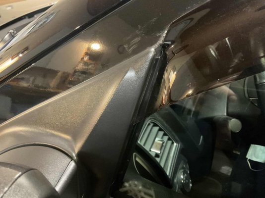

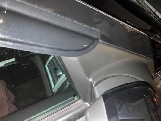

I have a 15 and a 19 Explorer. AVS vent visors on one, Ford dealer bought on the other.
I do not like the AVS as at the front bottom above the rearview mirror, they just lay on top the door frame, I have to fill that little gap with double sided exterior tape.
The ones from Ford tuck into the plastic between the mirror and door frame. So much better. If you put these on, open the window to whole way first, and start with tucking in behind the mirror, then line up the top and back end, makes it a bit easier.
See pictures, AVS then Ford
