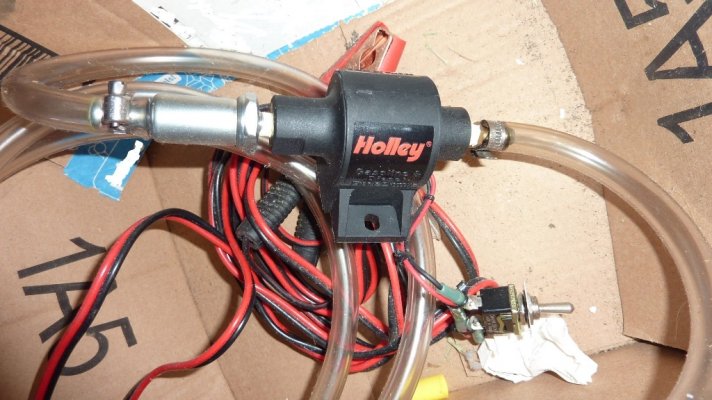

People don't have much luck just using a standard syphon system on the Expy's. I made up a small fuel pump assembly using a Holley electric pump and some 3/8" clear tubing. I wanted something simple enough for my wife to use if I'm not here. You can take power from a cigarette lighter port or use alligator clips direct to the battery of the vehicle . Works great and pumps fast enough. I added the switch, and I just store the whole rig with my extra gas cans and the generator.... I keep my boat full of fuel for such occasions ....
Holley Electric Fuel Pump / Emergency Fuel Pump Rig
