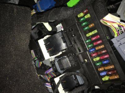

The dealer hired a sub that improperly installed the wiring to my DVD player. They are out of state. Local ford dealer unhooked it and solved all sorts of stuff being offline. They had used the number 36 fuse that controls park assist, pre collision, etc.

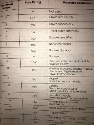

With the virus concerns, if I can fix this at home I should give it a run. I see the number 9 fuse is for factory rear entertainment and heads up display. 10 amp. If I can get at it and if the wires are still laying there, I can probably skip a 35 minute trip to a local installer.
I’ll probably end up running food to our parents that live 1.5 and 2 hours away because this won’t be letting up and they are of course at high risk. The kids will go nuts with the blank screens. The guys that did this were somewhat supportive for a resolution, but deeply skeptical.
I don’t have a wiring diagram for the dvd and nothing for the truck of course, other than the owners manual showing the fuses and saying it’s “behind a panel.” With three little kids it’s hard to carve out time to dig into this. Any help would be appreciated.

I did end up finding that it’s behind the pass side kick plate. Too late to go out tonight and look, up the pics I saw look daunting to find what wire goes to which fuse.
Hope dvd wires are easy to find.
I even found an installation guide from voxx for the 18 up nav. It and the installation guide for this setup both just have generic paragraph stating you need to find a keyed 12 volts. Color codes for wiring would be much better.
also figured out it only draws 3 amps so I’m thinking the ten amp one for the one the factory uses should suffice.

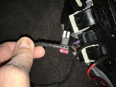

Been a tough weekend for it with the kids. They are going nuts already. Been calling older relatives.
going to try tonight to go out and see if the wires are at least present. Also not sure I have a tap. Could be hard to get at this point. We are headed to national lockdown within a few days.
