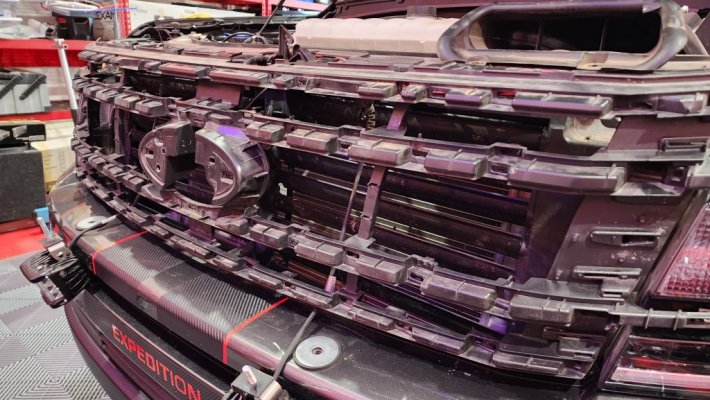

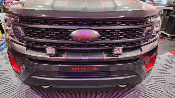

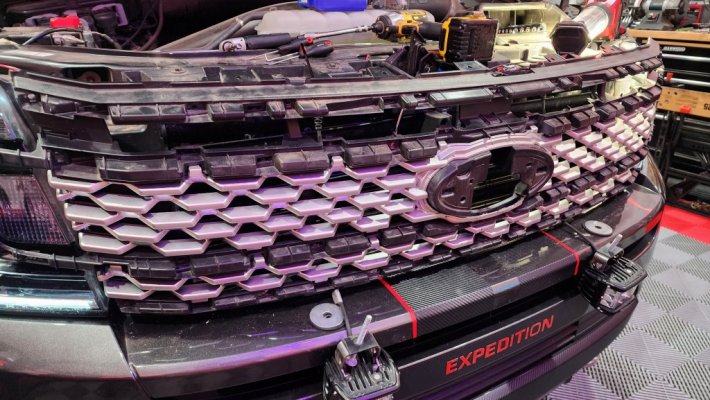

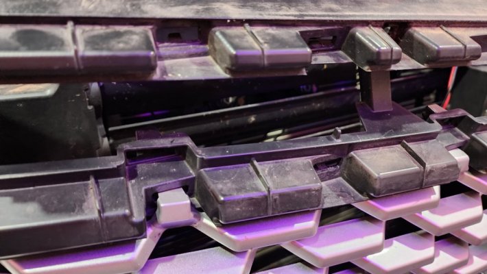

Well it's taken me about 10 days and about 36hrs of work all together but I repainted the grille insets of my 21 Platinum. And let me tell you it was a pain in the rear lol. It is possible to remove all grill components without removing the front bumper. But wow, lots of small screws and dozens of clips holding them in. But with patience and lots of inspecting I figured it out. Originally was using a small die grinder to rough up the paint but just wasn't cutting it, so ended up buying a small sand blasting unit from harbor freight to attach to my compressor. So much quicker. Then once cleaned, i treated the plastic with rustoleum adhesion promoter, followed by two coats of rustoleum gloss black, then two coats of rustoleum clear top coat. Here are the before and after pictures.

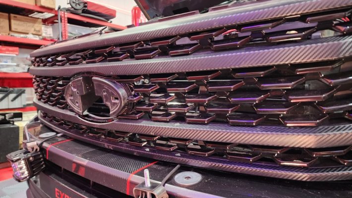

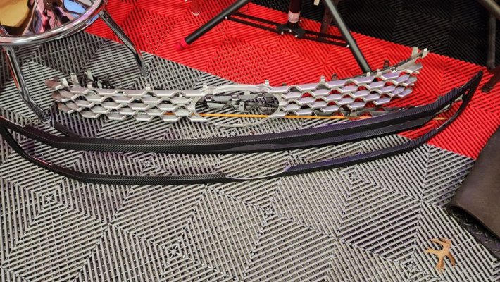

Here are the rest of the pics and finished result.
