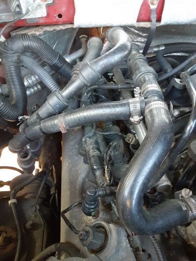

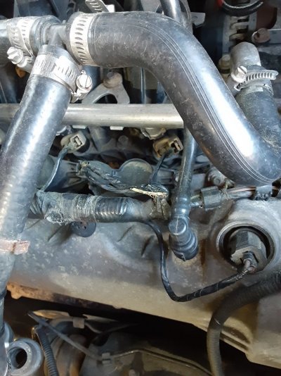

I was locating the number three ignition coil and notice there was a yellow wire almost completely cut from the number one coil. Would this effect the rough ride too?
